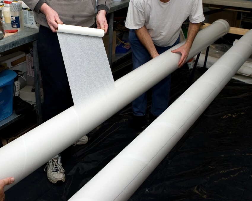

 Post subject: Re: Mandral jig
PostPosted: Wed Feb 03, 2010 1:53 pm
Offline
Posts: 1600
Apologies for the large photo, but the resolution is required to see the detail............
Wrapping the mandrel, is definitely an art, and the photo demonstrates the overlap you are looking to achieve and the angle of the paper to the mandrel to get the spiral.

Is that being wound on 'dry'?
