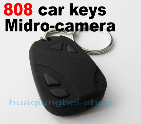

I got one of these to try out, I've seen some youtube footage of them, and they look pretty good, it does 640x480 @ 30fps
came with a 4Gb MicroFlash and cost me $15us
And weighs 16g
Youtube footage using this keychain gizmo

I've played around with the keyring version I have, and I'd say its about the same as a good mobile phone camera.
