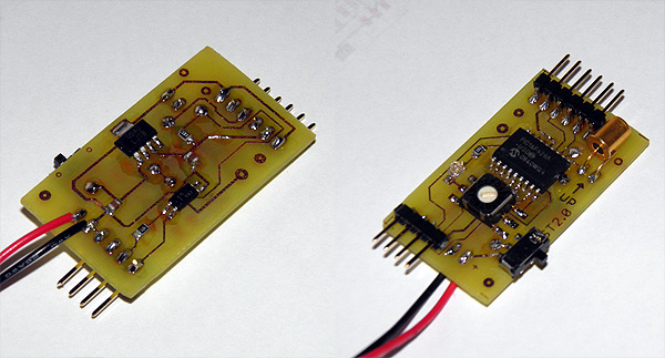

Okay to add to the cacophony of servo controllers, here is the first prototype of the ServoTimer II ready for flight testing:
Had a bit of trouble getting the chip programmed on the board initially but it's all good now. I've tested the timer now with several different configurations and even had the uMAD trigger it. I'll post a video of it working in the next day or so.
Next I'll make a couple more of them and then give them a good in-flight workout on several rockets.
A big thank you goes to PK for all the assistance, and practical tips. This is my first SMD project and it's definitely been a good learning experience.
- George

Looks good.
I might suggest some further mounting improvements for the slide switch and G-switch. Don't rely on the soldering to hold the parts in place. Solder is not very good mechanically. Two possible ways would be to:
a) Solder a loop of tinned-copper wire over the component onto pads on the PCB
or
b) glue the components to the PCB using a CA glue like Loctite 401 or similar, with a primer of some sort. They used to have a product called "Tak Pak", which was a CA glue and a metered-mist spray primer, especially designed for use on PCBs.
Keep up the good work!

Thanks for the suggestions OTT, I actually have a couple of through hole pads for the G-switch that does exactly that, a wire loop goes over the switch. you can see them on the bottom view (near top). This has worked well in the previous version. The loop is not fitted in this photo, but will be before I launch. I'm going to remove the G-switch in order to test another "poor-mans" mechanical G-switch that can also be fitted to this board.
The slide switch is a different matter though, and does feel like it could be pulled off with too much handling. I may have to go with glue for that as you suggest. It's the same slide switch the uMAD uses. I could potentially run a wire over the switch lengthways as well, but it wouldn't look very pretty.
PK: Have you guys attached the switch in any way on the uMAD?

The switch we use on the uMAD has a metal cover with two tabs. We simply solder these to the copper fill area.
PK

If you have LVP enabled in your config (the factory default) then the micro will assume you're going into that mode and won't program.
PK
Brilliant, that was it! :D Actually I noticed that RB4 wasn't connected to the rotary switch position #4 (circuit diagram I posted wasn't very clear) RB4 is connected to the G-switch so I just shorted out the G-switch which grounds RB4 and the PIC behaved itself and was recognized and allowed itself to be programmed.
I guess we all learn these little bits of knowledge by doing things the hard way. :wink:
Here is a video of the timer at work, it shows normal operation, how to configure it, connected to the uMAD and chaining them so you can drive multiple servos for staging and parachute deployment, or drogue/main functionality etc.
